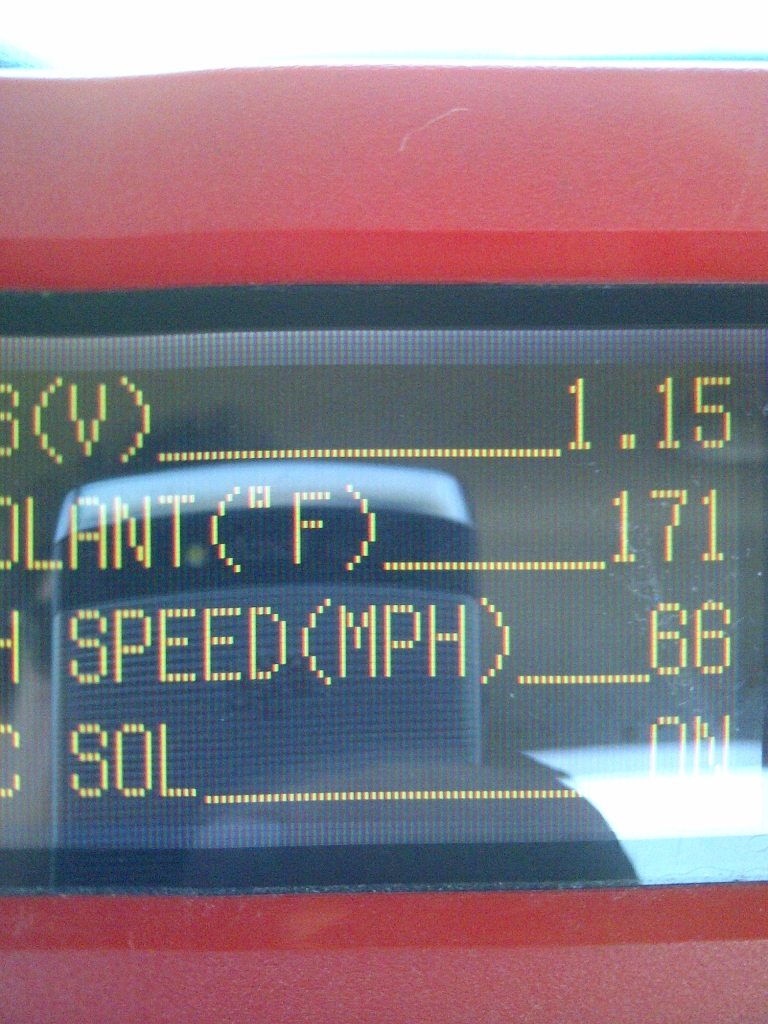

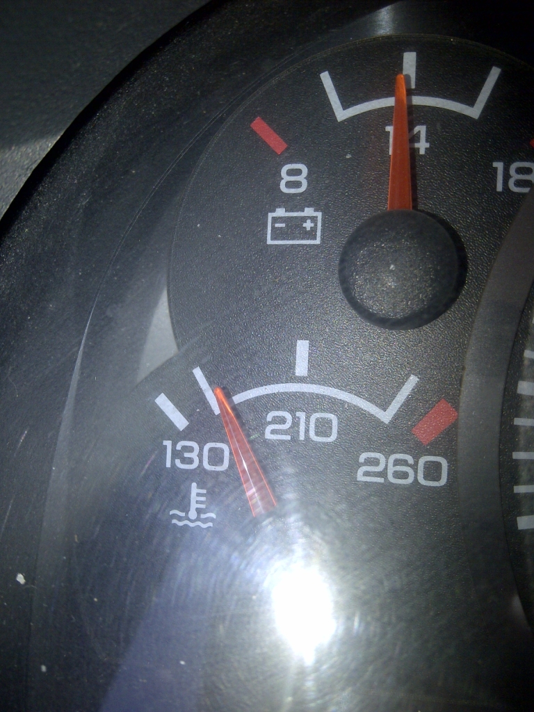

I bought and installed the TCP kit. Installation went very well, and it works great. The kit was missineg one little piece - one of the 8 plastic clamp pieces taht hold the fan. I coantacted them and asked if they could send one. They sent 4 at no cost, and I had it in two days.
The TCP kit is probably one of the most expensive ones out there, but their customer service was excellent - and that is worth quite a bit in my book. Quality of the work on the parts was great. Programming was pretty simple with three different temp setttings and ranges. When running around town (my office is 10 blocks form the house) liekt o and from the office or post office, the fans trypically do not come on until I turn on AC. Running a 180 stat and AC running, fans keep temps down sometime under 180 (I runa a 180 stat and tune)
