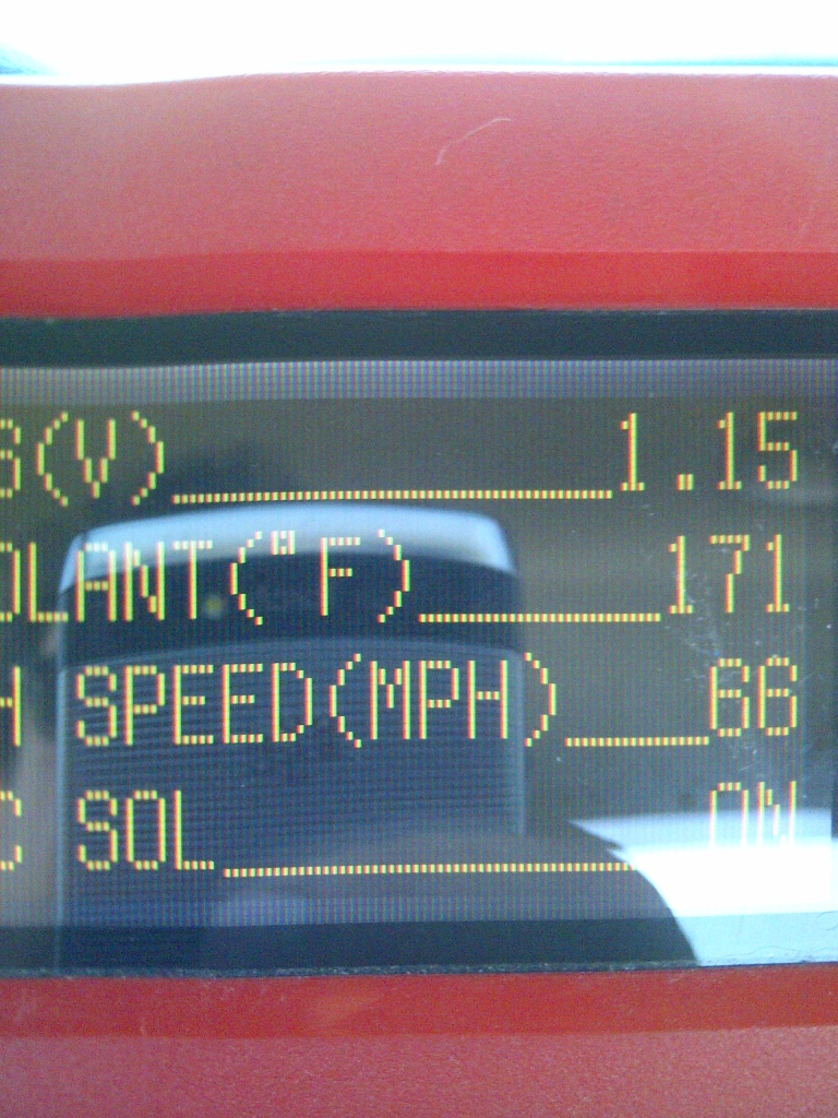

[QUOTE=gdstock;2815453] Name:  IMG-20120615-00635.jpg
what electronic item is this? kinda has me interested!

[quote=redneck_ram;2819597]
This is a Snap On MTG 2500 graphing scanner. It reads most, if not all, PCM data, and with the trans module, it even reads trans temp and pressures. Monitors O2 sensors, IAC, TPS, engine temp....everything I can think of. Will also graphe it, print it. Great tool. Snap On discontinued it when they went so solus I think. Picked up on ebay pretty reasonable. Reads codes, clears codes. Don't know how I got by so long without something like this.

[QUOTE=gdstock;2820128]
thats only for OBDII+ systems right?

[quote=gdstock;2820128]

[quote=wjxavier;2820227]
No. It will also do non OBD systems, if you have the adapters for it. The set I have has a number of vehcile specific adapters fro some vehicles back to the mid 80's.
