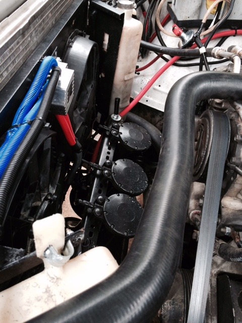

Thanks, I will get some close ups. Basically I just took a welding class, so this was kind of a project to test my skills. I welded two arms from the top and bottom of the frame around the electric fans and conduit clamps to secure the tabs of the washer fluid tank to the arms. For the coolant over flow I used a piece of sheet metal formed it with an angle to attach to the frame of the fan shroud, then used a metal nibbler to cut the tabs out the same as the factory plastic shroud.

These are the e fans installed. The odd circles are train horns i decided to put in with the available space provided by the e fans.
