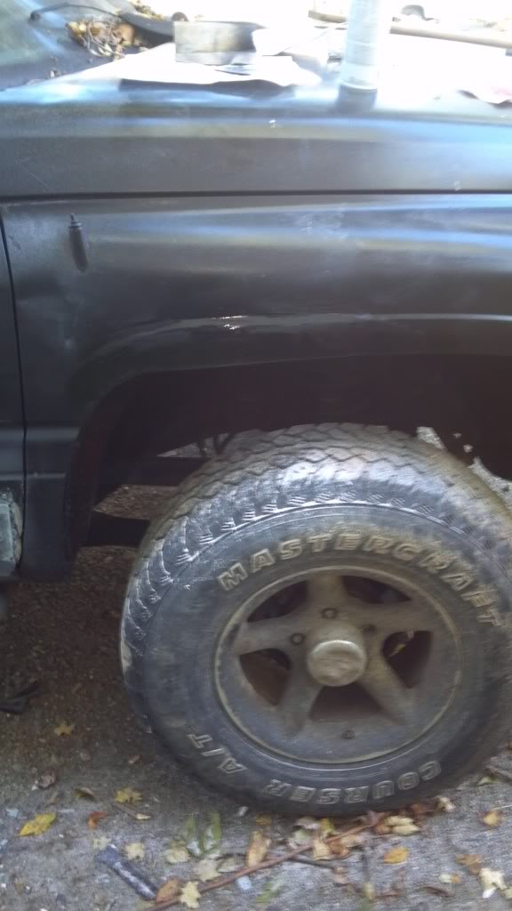

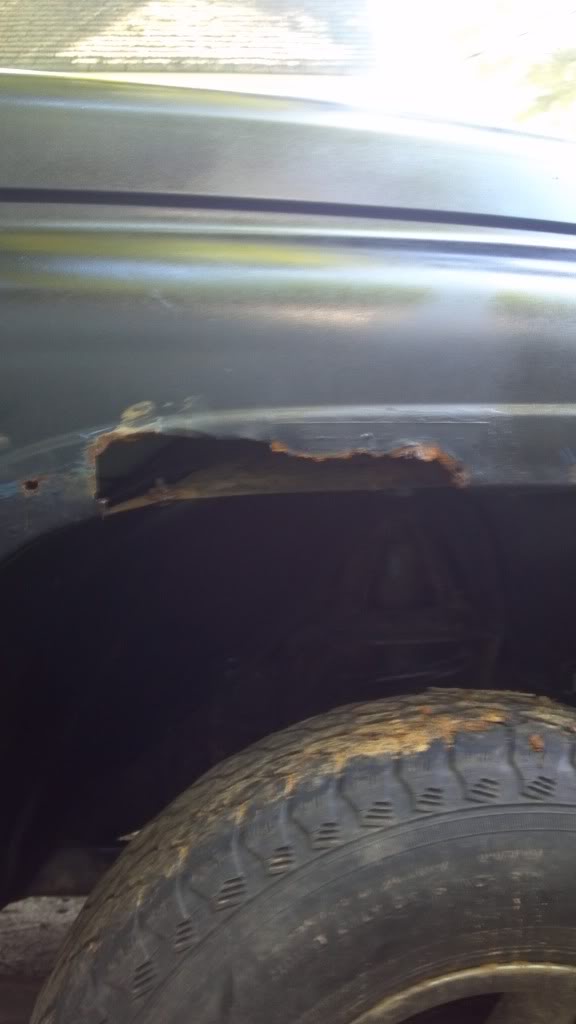

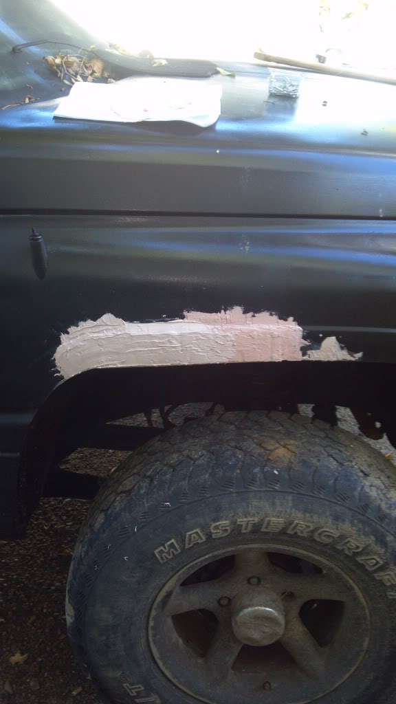

Alright got some work done to the fender....cut the bad metal out and replaced with sheet metal and some bondo to cover rivets....
Heres how she started

And now
Still need alot of sanding but looks 100x better already

And now after sanding.....i put paint on it already because the black shows inperfections better...needs a little more work....but not bad for a $12 repair instead of paying $75 for a new fender
