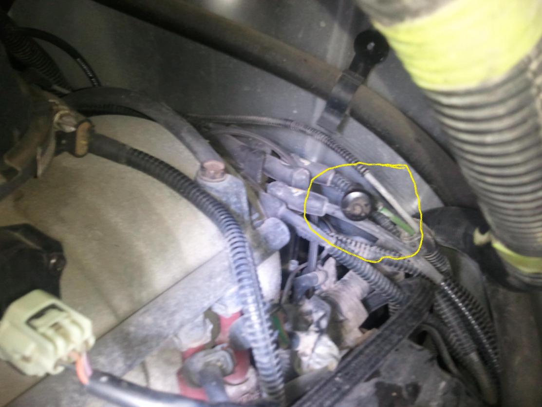

So, I read through the vent post and this led me to replace my pcv valve this morning. After doing that it seemed that my TC was working as it should. I only drove it a short 10 mile trip but it went up a hill and the TC stayed locked, something that it hasn't done before. I will take it on a longer trip this weekend and that should tell me more. Maybe this could help my MPG too!!
It didnt help my vent problem though. I have attached a pic of a vac line I found while searching around my engine bay last night. It appears to be coming from a plug on the Transfer Case and comes out on the driver's side of the Distributor. I cannot find where it goes. Does it plug into anything? It is the green line in the pic.
Old Aug 16, 2012 | 02:19 PM
Posts: 87,480
That is just the vent line. It doesn't actually go anywhere.

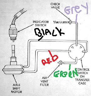

+1... Does 4x4 and cruise work? Read the wild vent thread. Heres a pic of the Transfer case lines.
