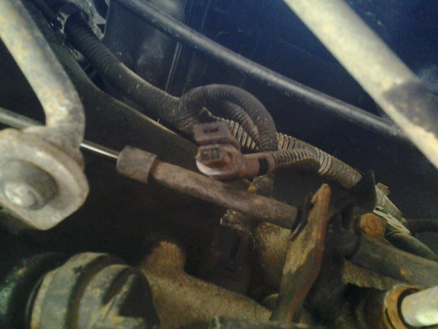

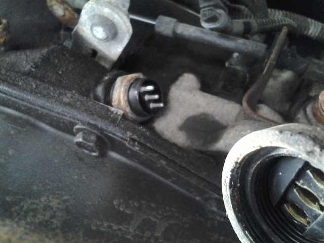

Also heres a few pix theres one plug on the side&one on the top.The smaller on the top was wet when I pulled it.Also theres another connector Not plugged into anything.. I didnt have a factory tow package so no trans temp sensor

First pic is the park/neutral switch. (right under the linkage.) The connector for the solenoids should be right above, maybe slightly to the rear... of the rear cooler line. Can't really see it in the pic. If you have a two wire connector there that is indeed strange.

I see one plug in on top no idea should there be two plugs up there?Yeah no idea what that loose plug is for.
Old Aug 22, 2012 | 03:54 PM
Posts: 87,483
Should only be two electrical connectors that actually connect to something ON the trans..... Can you get a pic of the other one??

Heres the pic...only one. spot for a plug to go&thats where its plugged i to...the one Thats nots plugged into anything I belive was for if I had. a trans temp sensor.
