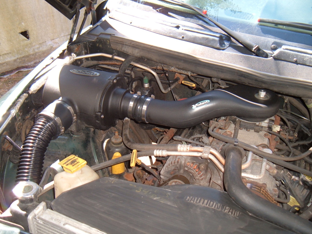

Originally Posted by zman17
Umm, no they don't.
If you have seen one that doesn't, I would love to see it.
Old Sep 16, 2012 | 11:27 AM
zman17's Avatar
zman17
Retired Moderator - RIP
Posts: 18,729
Likes: 17
From: NH
K&N, Spectra for instance do not draw air from the stock location. A Volant however does draw air from the stock location. Name:  DSCF0740.jpg
Old Sep 16, 2012 | 11:37 AM
Posts: 87,554
Likes: 4,230
Huh? They don't? They have the filters right there by the fender, and a 'box' around it.... still getting air from the same place. Got pics?? or links??
