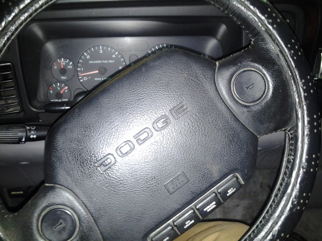

Well...I had already put it on &couldn't find my grease pin,so below is a pic of how the steering wheel is off center.I had pulled the steering shart before without this problem.I guess to correct it.I need to get the wheels straight&pull the shaft&spin the steering wheel till I get it where it should be.Got any tips or anything else I should do

Yeah dude check out this vid..you should fix the the issue 1st then fine tune to get it true, hope this helps:

There is a adjusting sleeve on the drag-link arm that you can use to adjust your steering wheel.
