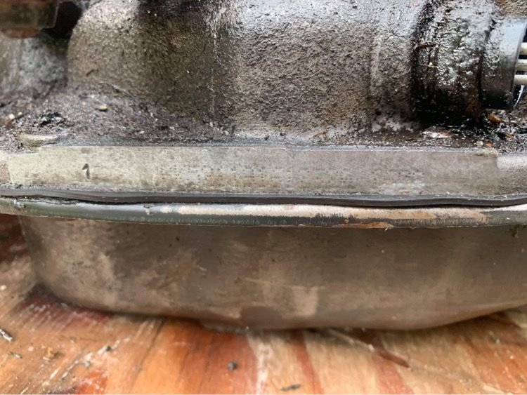

Hi, I’m trying to identify a Dodge Ram trans with the following ID number:
RK521191613520 (can’t read the separate 4 digits after)
the ID might be
RK521191612320 or -2520 (sorry, I only have a picture that was sent to me and it’s really faint/unclear.

Those numbers don't come back as anything at all. Can you upload the pic?
Here's the only image I have (sent to me, and the guy is ~2 hours away) - I have tried blowing it up to 200% & 400% but it's still super hard to make out the numbers...

I can see a "1" there, and nothing else.
I just google the number. If it is a valid part number, you will get quite a few results. If it isn't, you get none, or really strange ones, that have nothing to do with transmissions.

Ok, I went back and looked at some other posts and saw that folks had the first two letters of PK (I thought I was seeing RK) - so I googled PK52119161 (I'm pretty sure about all those numbers from enlarging the pic) and got 2 hits...
One of them was on mmerlinn.com, and lists the following:
LU, Rwd V8-52
Case = 064, Yellow plug, 15/16" hole, 3 threaded bosses, Screw-in NSS
Tail = 17905, Speedo, No sensor, 3 threaded bosses, 2 blank bosses
Top valve body = 4617003
Center valve body = 52117848
Bottom valve body = 52118357
Cheese plate = 96
Pump body = 4505033
2.5 lever
Overdrive tag =
The other one comes back as: https://bestremantransmissions.com/d...0304ddg6o.html
Given there's no speed sensor in either, and the second one calls out the white 3-pin connector, I think safe to assume 46RH.
Thanks for the idea of just googling the number! I thought for sure you were hitting some parts interchange database.

Leave off the PK, and search on just the numbers, and I get numerous hits on a 46RH trans.
