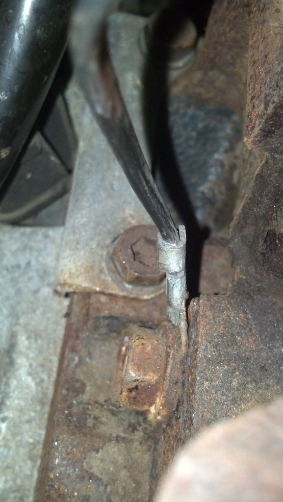

i was trying to get at the crank sensor and noticed a few things so i took some pics, phone screen isnt large enough so i wanted to post them so i can check them out on the laptop.
i think i might have found a bad/burned ground. plus i noticed that the groment for the crank sensor looked off, might have been changed before, idk. just need to check on a bigger screen. comments welcome if anyone has any.
I don't believe that to be the problem...its just a frame ground. Did you by chance change that plenum gasket yet and get check the quality vacuum hose that goes to the map sensor? $21 for the gasket plus $6 for the bypass hose, I'd even come down to Point to help ya out with it.

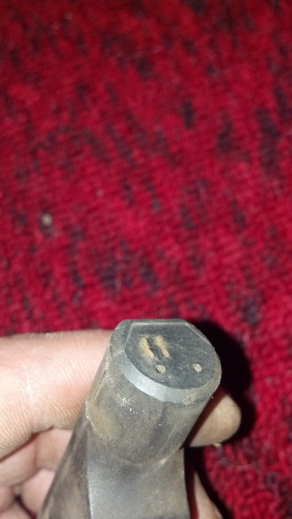

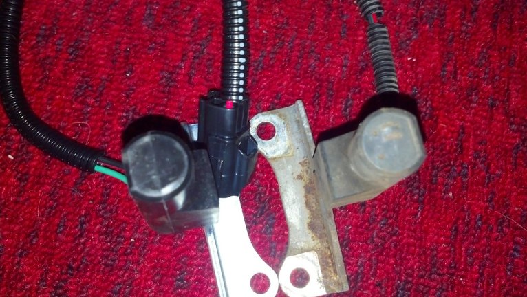

got that crank sensor out after going at it for 2hrs today.. what a PITA, doing it for the first time and by myself didnt help but o well its out.
got a few questions. the one i pulled out has 2 little holes on the face of it, the new one does not. is that gona be a problem?
and i see what looks like a groove maybe. im not sure if it hit the crankshaft or not. it kind of looks like it to me.
i'll add a few pic's. my main question is, is it gonna cause any problems w/the new one not having those 2 holes?
if the "groove" on the face is from hitting the crankshaft, i believe the reason is, they didnt have the rubber seated right and possibly over tightened. idk.
the "groove" i was talking about is in between the 2 rusty looking lines on the face in the last pic. it is hard to tell in the pic i guess. you can tell that the plastic on the face between the 2 lines have been hit by something.
i'll go ahead and throw this new sensor in and call it a day.
