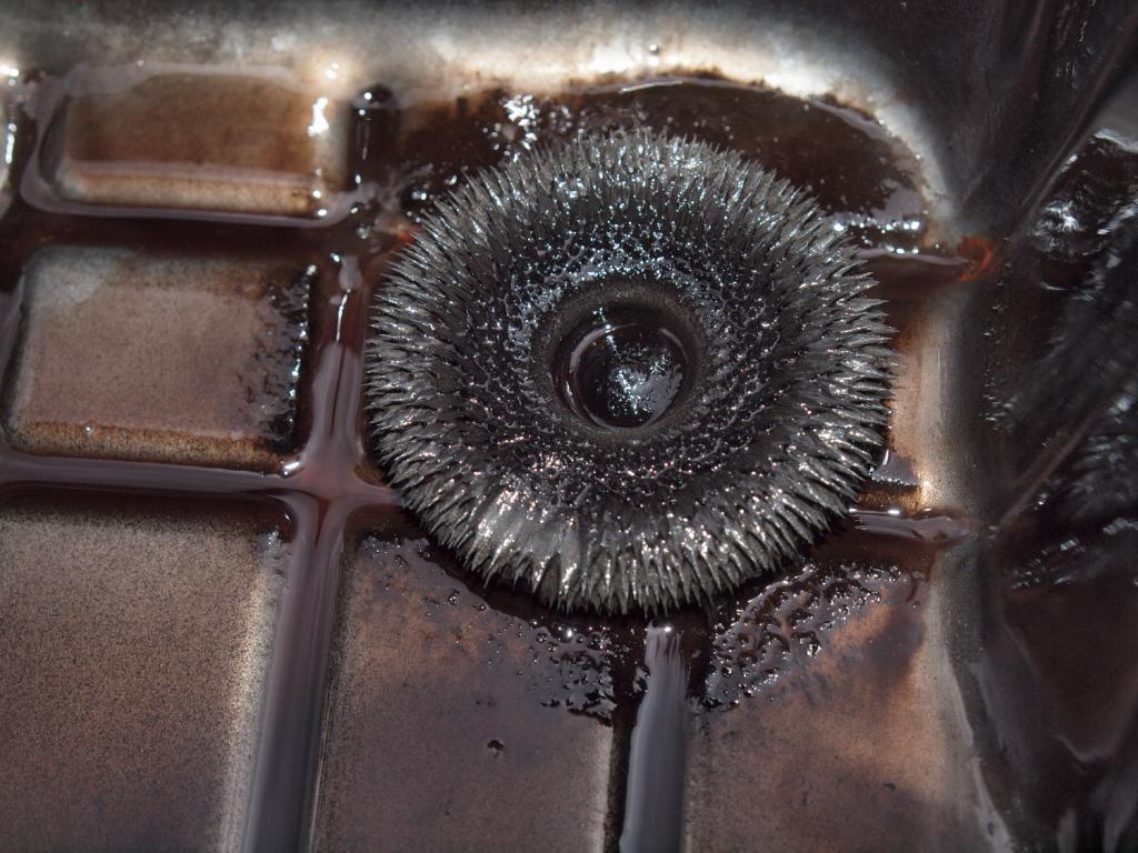

Had a chance to pull the pan this evening and found two problems. The first is the front band is very loose. It can be lifted off it's piston about 1-1.5 inches. That seems excessive so I hope it can be adjusted out with a simple band adjustment. The rear band wasnt loose. The second is the amount of slivers found on the magnet. Here is a picture of that. Tommorow I'll pull the valve body and look for more issues. The good news is that I found nothing larger than the slivers in the picture.

Old Mar 17, 2013 | 06:09 PM
  #29
stewie01's Avatar
stewie01
Joined: Mar 2011
Posts: 8,914
Ouch. That's a fair amount
Seen more, seen less. Can you post pic of how loose the band is? By piston I assume you mean servo. If so, it should not have that much gap. That inidcates that at full stroke on servo, it is not fully engaging the band on the drum to hold it tight. See if you can see scoring on drum under band.
