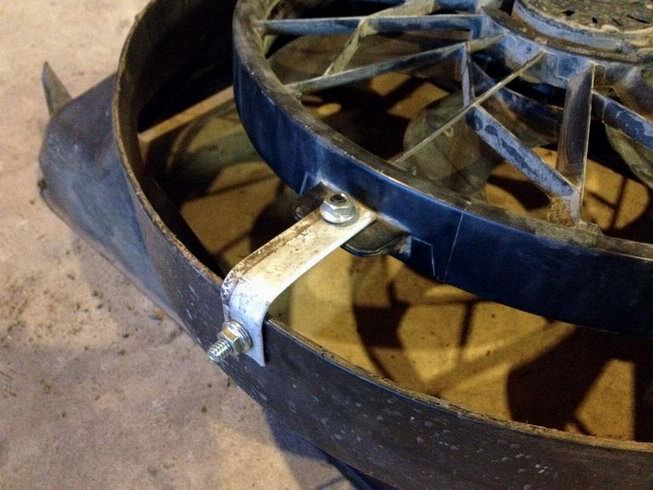

Take a look at the photos how i placed the fan in the shroud (wires from fan go towards engine).
I bolted the fan from the inside of the shroud using 5/16' short bolts and made a L shaped bracket out of aluminum for the 3rd mounting bolt of the fan. Take a look at the photos and you'll get the idea.
So after drilling and bolting on the fan to the shroud, take your time to put it back into the vehicle, make sure to keep your eyes on the water pump thread, it's gonna be grabbing onto the fan during installation. The fan will be at least 3/4" away from the water pump so don't panic, the engine moves LEFT-TO-RIGHT only. There will not be any contact between the fan and the engine if you install the fan inside the stock shroud.

What would be the differance mounting the fan to the shoud and mounting it to the radiator ?

If you mount the fan onto the radiator, then you cancel out half the vacuum created by the fan when using the shroud. The shroud is big, but it pulls all the air through the whole radiator and like i mentioned above, stock shroud has 100% coverage and it was designed by engineers to be very efficient.
