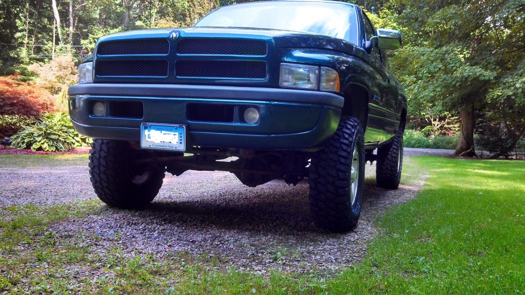

Thank you so much for that tip i shouldve realized that lol well here it is stock
and here it is after 2.5 spacers and blocks and 33" M/T and removal of front valence
no when it comes to more mod i want a roll bar in the bed and probably either a cam and 1.7 harland rockers or just 1.7 i dont wanna blow my tranny and im really looking for more torque then hp also that eargasmic idle ad rumble with with the rockers

Edited your post a bit so the pics show. I just copied the URL, clicked on the 'image' button, pasted the URL in there, and viola! instant pic.
How do you like the tires??
Good Lookin' Truck.

Thank you, and the tires are nice a bit noisy on the road but doesnt bother me too much.
