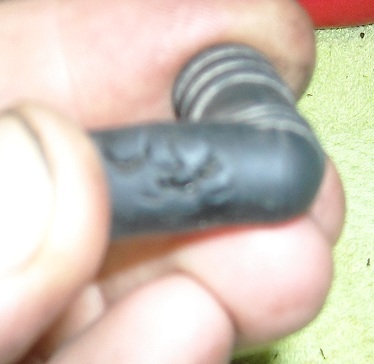

generaljr - ok so going back in again to check for vacuum leaks.. I found one! The elbow coming off the intake that goes to vehicle climate control, speed control, and 4x4 axle had a piece of black electrical tape around it that was coming apart, when I removed it, or actually crumbled the tape off, i found this chewed up elbow (see pic)
going to replace with some scrap tubing I have laying around for now until I can get a new elbow. Thank you !
replaced that with a piece of tube from a 97 Integra evap canister I had sitting around, it's hook shaped so worked perfect. When shutting off A/C the RPM's appear to stay pretty steady. Still have my p0505 but at least I know this potential future problem is temporarily fixed.
