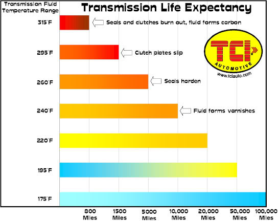

That's a pretty normal temp for it being 95 degrees out. I'd still install a n aftermarket cooler if you tow. Do a search on here and you'll find lots of info on coolers.

I've got a cooler in front of the condenser, and it's not ran through the radiator. Out of the cooler I was getting about 172 degrees. Then it warmed to 190 by the time it got to the trans.

Get a bigger better cooler. And it should run through the radiator for the colder months.
