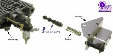

And what is a upgraded sonnax tcc switch? I looked at it on patc website.

TCC switch just gives better flow to apply/release circuits. Designed to reduce/eliminate apply shudder, and a few other issues.

Will I have to disassemble the vb to put that in? I haven't tried like that but it doesn't seem to do it if I take a long distance to stop. It's when I stop somewhat abruptly.

Not sure just where it goes.... I would think it just replaces the TCC solenoid in there now. It is *possible* to change those solenoids without dropping the vb, but, not sure if that would apply in this case.

#6. "Improved Torque Converter Lock-Up Clutch Switch Valve." The circuit timing of applied vs. release pressure exhausted is critical for proper TCC operation. The OEM valve stroke contributes to soft TCC apply, shudder complaints, and increased damper spring loads. Replace the OEM switch valve with this Sonnax’s switch valve. The new Sonnax switch valve improves the timing and flow to the apply and release circuits. Fits 42 / 46 / 47RE / RH . Cost $17.00
