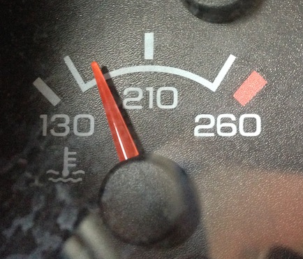

After replacing the temp sensor, I warmed the engine up in the driveway for 10 minutes, then drove around for another 20, but I still can't get the engine to warm up. The image below is the gauge at the end of a 30 minute drive in the heat of the day.
Could it be a faulty or mis-installed thermostat? I know it could be that, but is that the likely culprit? Or is there something else?

That's where mine was reading with a 180* stat. I was also getting the "too cold too long" code.More than likely that is what was put in. Replace it with a 195* and you should be good.

My 180 reads 180.

Replace the thermostat with a 195 unit. Skip the failsafe fellers. They are too 'safe', and panic easily. (and stick open, which is what it looks like is happening.)

Yeah probably a 180* thermo. Either that or its stuck. I had the same issue with mine, at first it was with a stuck thermostat, and the second time was because the parts guys gave me the wrong thermo (180*) and I needed a 195*. I always run Stant thermostats, and always put those into my customer's cars.

Yupp as stated most likely a 180 degree stat. I have a 180 degree stat and get that code from time to time, I just ignore it.

A quick update on this: I got a code reader and watched the live data as I drove 10 miles to work (80F outside temp). The engine coolant temp never got above 163F until I parked and turned the engine off. At that point. the temp went up to 174F within about a minute.

Wrong thermostat in there.
