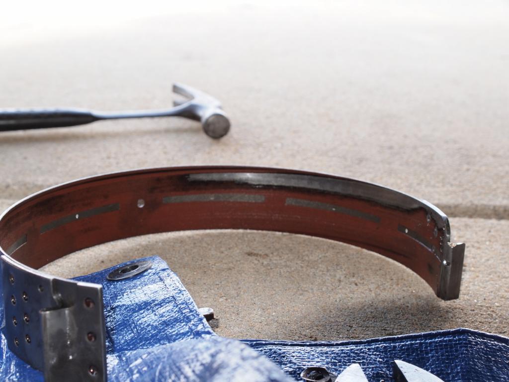

They seem to be a good temporary fix. I got 16+k and 17 months out of my slip-on band before the transmission failed for other reasons.
A little worn on one side but still grabbing.
