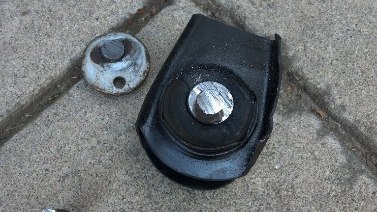

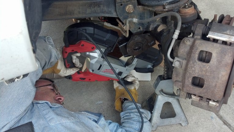

Been there. Can you get one of these from the tool crib?
Blade is just thin enough to get b/t bracket and control arm, which avoids scuffing/cutting into the control arm brackets.

WN... what the hell is that? A portable band saw? I can swing in and ask the carpenter shop as well as the tool crib. I'm up now, slept in a bit (0830), but gonna rip to Canadian Tire for some blades and will stop in on base and see what I can find.
