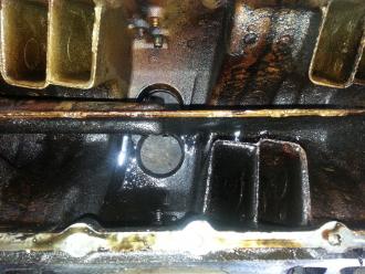

Ok so I pulled the intake to day the plenum is shot im gona clean the intake today and put it back on tomorrow

This is what it looked like in there

Yep, that ones blown.
