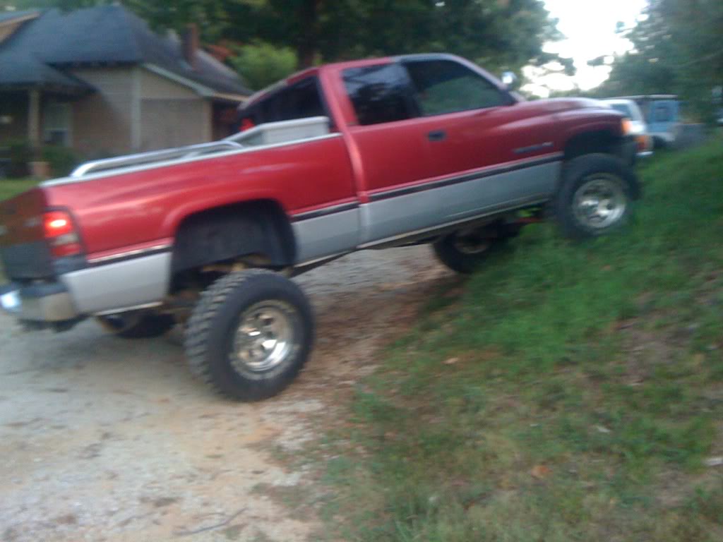

I ran 15x10's with 4" back spacing and 35's with a 5" skyjacker lift and never rubbed a bit.
Only old pic I could find. I wouldn't let them cut anything.

If they need to trim something is done wrong, my buddy ran 315/75/16 tires on a aluminum rim that had 4in backspacing and was 16x10 I know because I had the exact same rims on my truck. Yet he only had a 2.5" spacer, no rub at all until he was at full lock on uneven ground.
Either the axle is off center, or pulled way back I don't see there being a problem.
