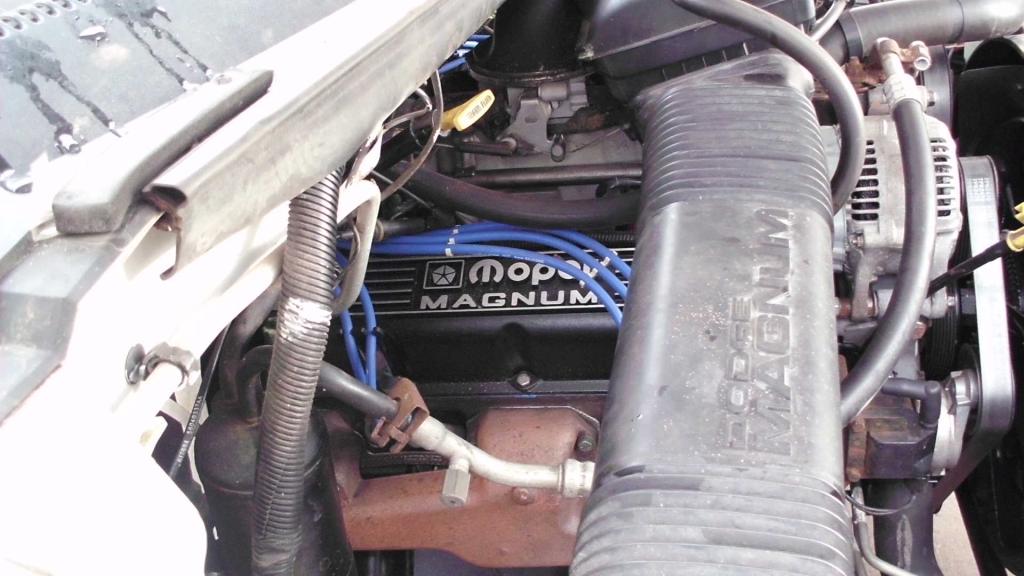

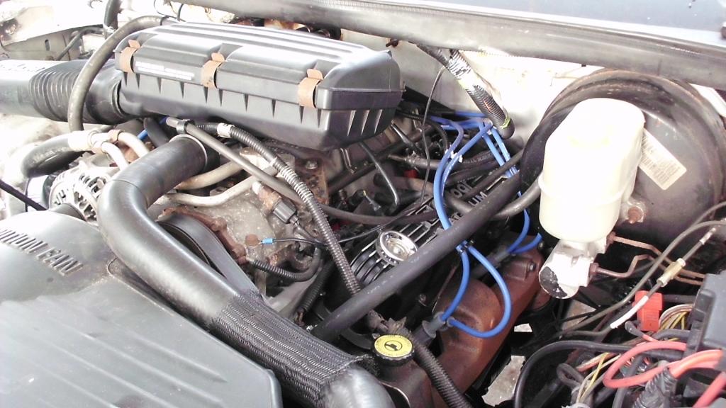

As for the pics...I can give U a final, but it looks like a new engine =). I didn't put it together so, no along the way pics. They did blast and paint the frame in engine comp best they could. Looks good. I'll get a shot when I change the front O2 tomorrow(unless u think a tailpipe out the back(longer) would be better?). Those VC's are tough.....MOPAR MAGNUM......Glad I got the used fuel rails...blast/paint and u really cant see them. Looks stock, looks new.
