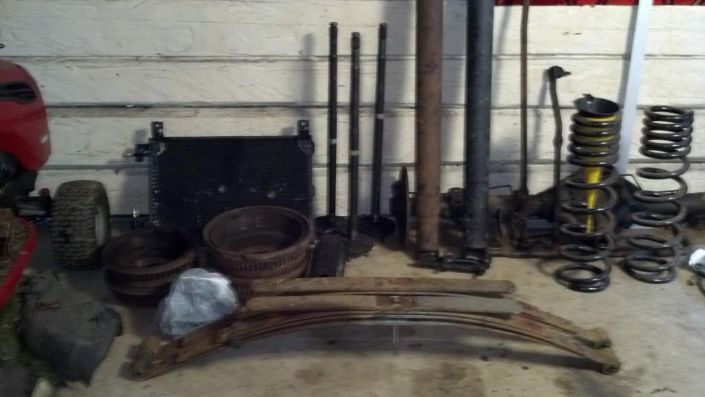

A pix of just a few of my spares that I am selling or giving away.
