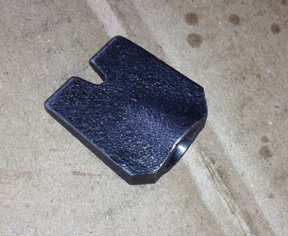

Default Found a metal part in pan
I Just dropped the pan to change parts and found a fork like part in pan? Where does that part go? This would be the issue for some of my problems.

Probably a band strut, or anchor. Can you post a pic? And yes, that WOULD be a problem.

Default Part Found in Trans Pan..
This is the part I found. I also noticed a very loose valve with things flopping around in it. The picture will show it. I thing I need to have it brought to a service Trans Repair Shop.

Yep. Band anchor. The loose/floppy parts are because that piece fell out.
Put everything back together, adjust the bands. Reinstall filter/pan/fluid, go for a ride. Probably work better.

Yes I just found a video on where that Band Anchor goes and on the side of the transmission is the bolt that tightens and loosens the anchor. I will drop the pan again and save the fluid and filter and try to put that part back in. Just need to get the tork ratings for the adjustments.
