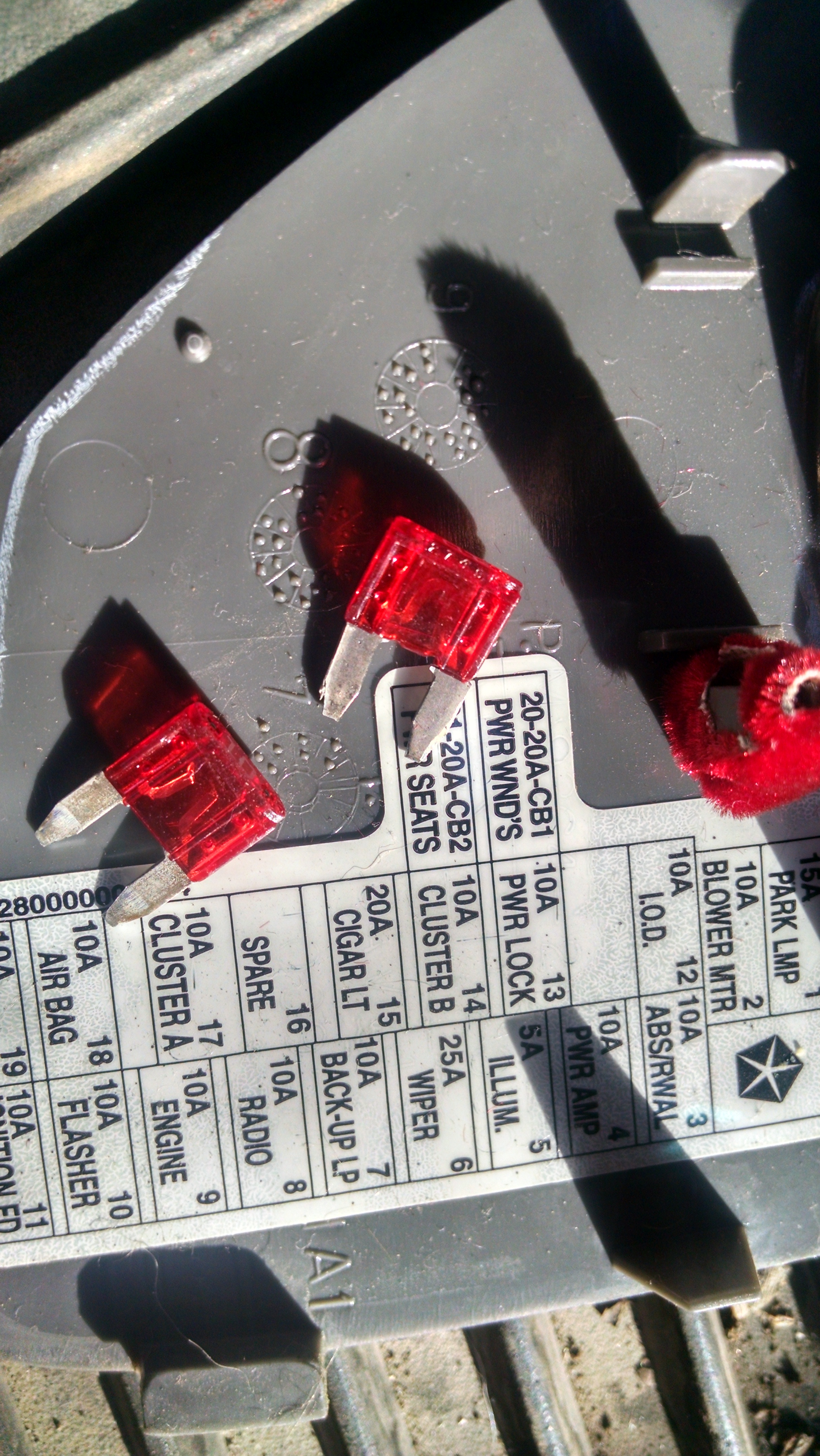

hmmmmm, may start here first as I've just noticed my reverse lights don't come on. All other lights work properly.

All working now.
Old Nov 14, 2014 | 07:02 PM
Posts: 87,479
Just a blown fuse? Gotta love the easy ones.

Good point on the ground. I was trying to think back the last time I noticed any issue and it was buddy's trailer. We had to DC some lights.
Anyways, all good for now.
