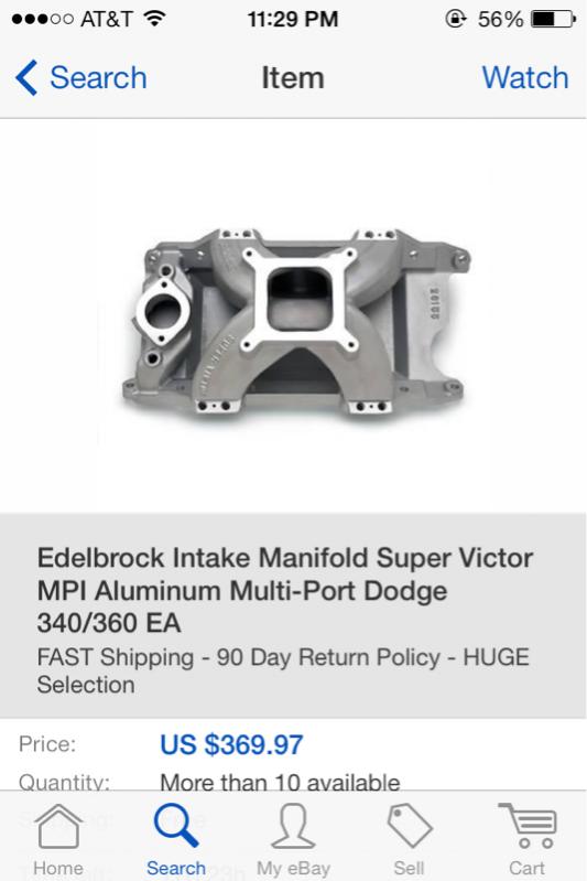

Is this one?

Won't work, that is for the LA style heads. Intake manifold bolts are at a different angle. You need on that will work on 93 and newer engines.

How can I tell?
And mines a 2000

Magnum intake bolts are vertical, LA intake bolts go in at an angle.
