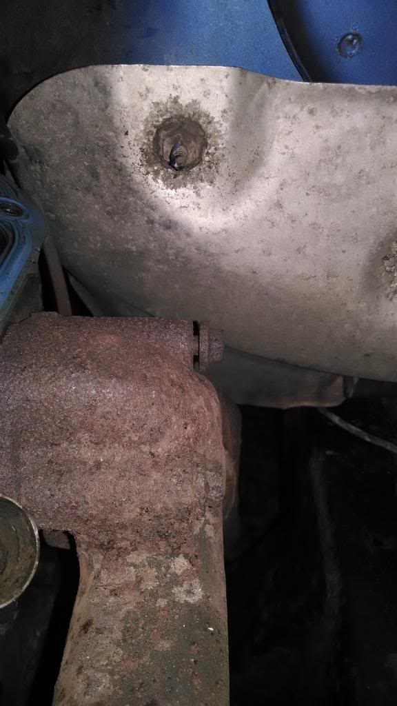

I also found a exhaust bolt that backed itself out.. There is where my exhaust tick was coming from. same location I always hear it.
