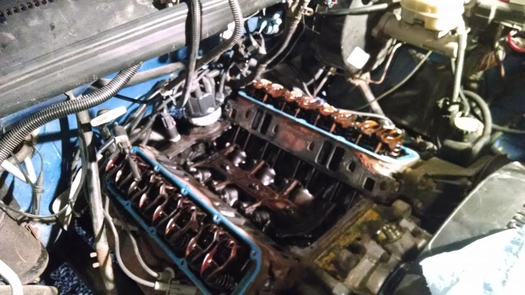

I'm not sure if you remember my 99 Ram and the thread titled, valve cover gasket nightmare (I think it was), I am just thankful the internals on my 98 ram is no where near the condition of the 99. Owners before me took pretty good care of it.
Old May 1, 2014 | 10:23 PM
xplorer82's Avatar
xplorer82
Joined: Jan 2013
Posts: 203
From: OhiO
Pushing 150k miles and all OEM gaskets.. Mopar stamped. Yup, been time to change them i'd say.
well minus the valve cover gaskets, someone changed them at some point obviously..
