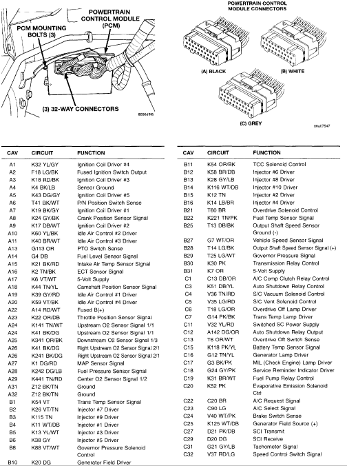

Hmmm, okay. So trying to make this easier on myself and find the wire near the PCM. I looked up the PCM diagram, would you be refering to B21 on this diagram?
What kind of bulb should I use? And should I use a specific guage in wire? Also should I disconect the battery before pulling the Wite conector intot he PCM to get a better look at the wiring?
I guess to confirm what your saying..... Could I find the right wire near the PCM add some wire and use something like a tail light bulb and splice it into the extra wire leaving the bulb visable outside my windsheild. Wiring makes me nervous, I guess thats why all the little questions about this test.
