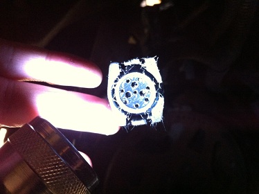

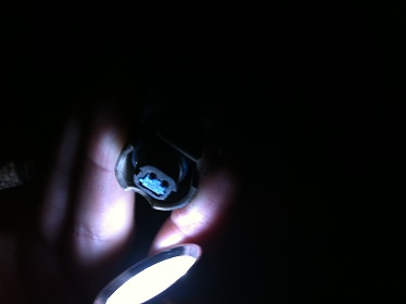

Now I have been at the workshop and looked at the truck. When my friend got all the paperwork home for the truck it turned out to be a year 96 truck and not a 95. And when I look at the connectors on the truck I have the following:
8 pin
3 pin
3 pin
2 pin
The gearbox only has the following:
3 pin
3 pin
3 pin
So I guess the truck needs a 46RE transmission and the transmission that he got with the truck is a 46RH? There is no way to get that transmission to work on this truck? I guess he has to look for another transmission?
Have attached pictures from the connectors on the truck.
Attached Thumbnails Change transmission on 1500 Ram 95-truck_8pin.jpg   Change transmission on 1500 Ram 95-truck_2pin.jpg   Change transmission on 1500 Ram 95-truck_3pin.jpg   Change transmission on 1500 Ram 95-truck_3pin_2.jpg
Old Jul 6, 2014 | 05:25 PM
Posts: 87,483
Backwards. 46RH (hydraulic) is for 95 and older, 46RE (electronic) if for 96 and newer. And no, you cannot make that trans work in his truck. Not without updating the entire wiring harness, and PCM. (granted, it is pretty much plug and play to do so though....)
