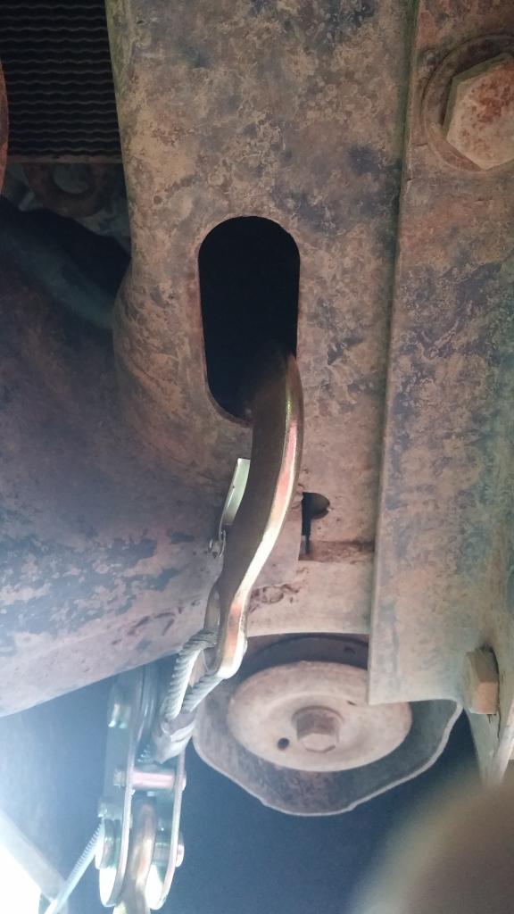

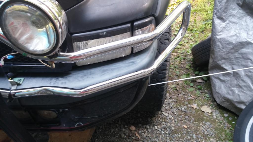

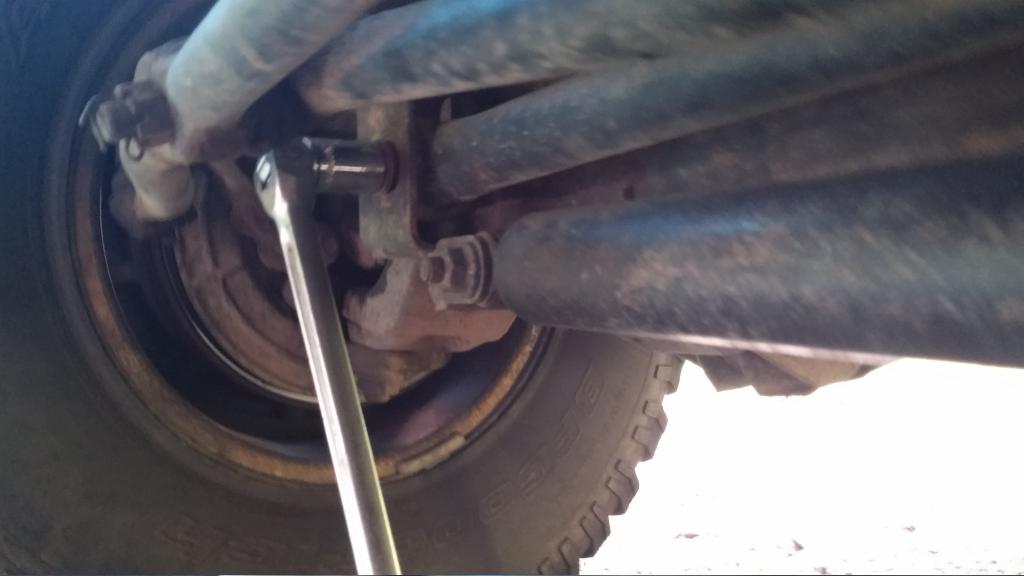

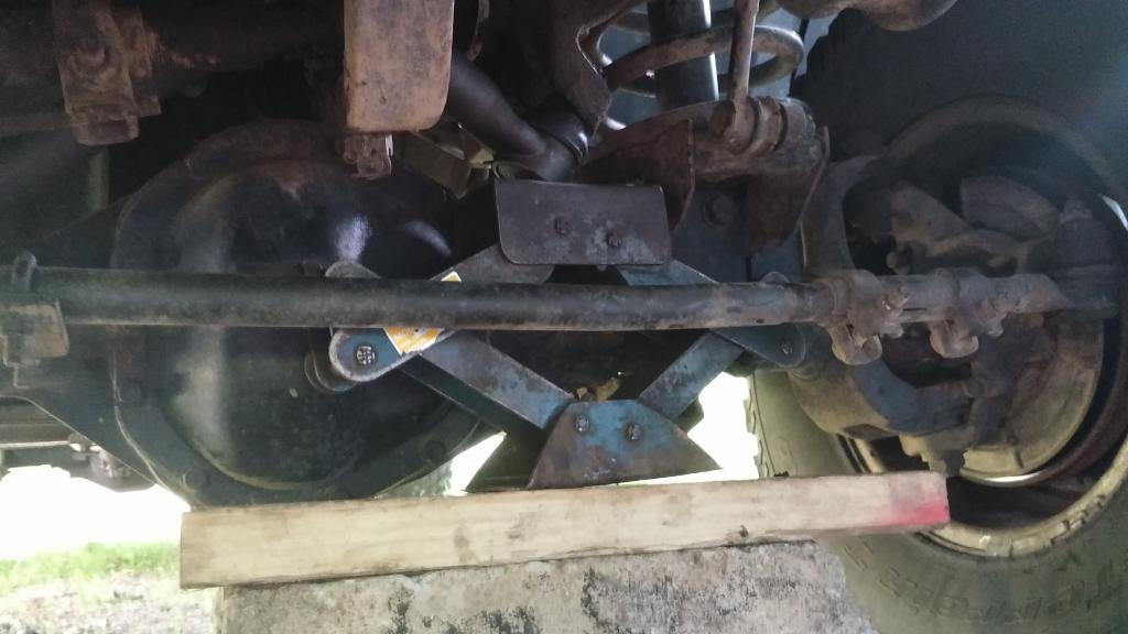

Size:  70.9 KBtook off the pin and castle nut at frame end, used 7/8 with a half inch breaker bar. You could keep the nut on to prevent the bar from dropping when you separate the ball joint, but i just took it off
next i loosened the bolt at the axle end of the bar, once again half inch breaker bar but 18mm socket.
to separate the ball joint from the frame i just used a pickle fork and a BFH (mine was a sledge with a weight on it lol) once the pickle fork can't take it out any more just wiggle it around, the ball joint should come out
here is the old track bar and new one, my old bar needed a little persuasion with the sledge to come out on the axle end
I put the axle end in first, didn't have room to put a come along to pull to the passenger side. This is a hole on the frame near the bumper
just another picture of where the come along comes out. You will need to do this, unless you're on a completely flat surface
this was how i put my ball joint in the frame. Wasn't a big fan of hitting it in with the sledge, then torqued the axle bolt to 130 ft/lbs and the ball joint nut to 80ft/lbs. It's 70 stock but the moog bar calls for it tighter
Attached Thumbnails death wobble-20140710_134538_zpsl6fklaoo.jpg   death wobble-20140710_134337_zpsk7kq9mr6.jpg   death wobble-20140710_144957_zpswsmb7bwa.jpg   death wobble-20140710_144942_zpsjwbr6lha.jpg   death wobble-20140710_143744_zpsnf0zohlt.jpg

Yeah that would work too, but i was on such an uneven surface it didn't work too well with someone pushing. I just had to use a come along
