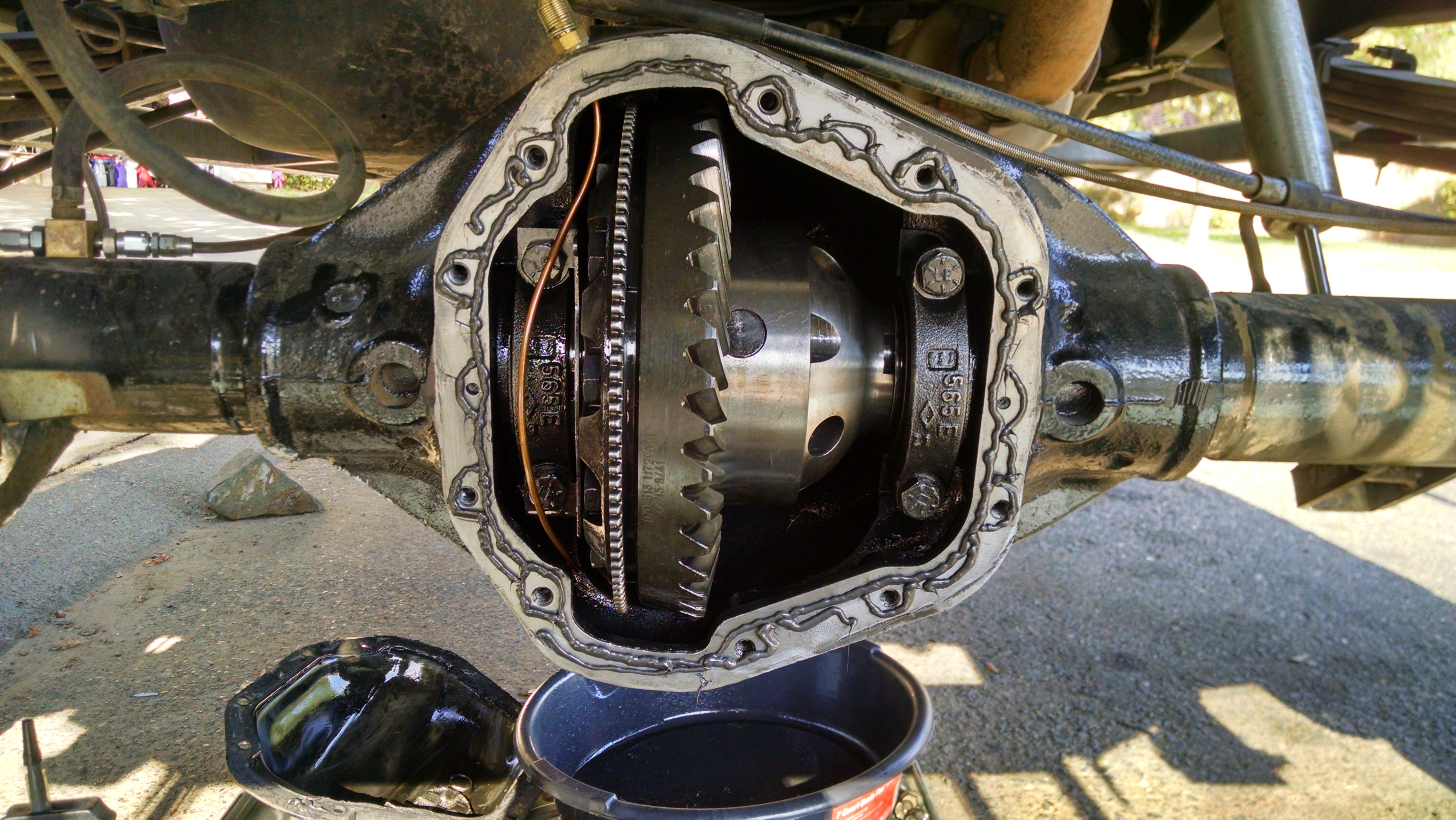

As said, get the proper gaskets (felpro) for the VCs. Be done!
Here is rtv for diff. Be done!

How long do I need to wait for the sealant to dry before adding gear oil? I torqued the differential bolts per Haynes manual (35 ft lbs). The oil that came out was way overdue for a change. Bits of the old gasket were in the bottom.
I did get fel pro gaskets, k&N oil filter, and a new differential plug. Used a wire cup attached to my drill to remove old sealant.
