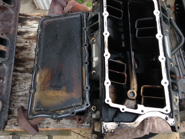

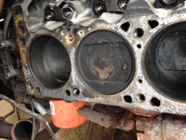

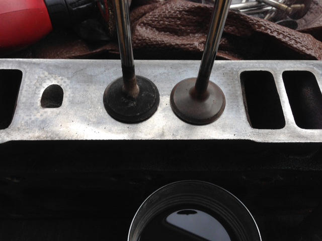

Its been awhile since I posted. I have, since then, rebuilt the engine but did cheat to cut corners to make it more cost efficient. I scrubbed all surfaces with a paint rust remover wire bush that I attached to a drill. I cleaned all valves, pistons, putnam plate, all gasket surfaces and then used mineral spirits to clean oil off of the rest of the places along with soaking parts and all bolts.... that stuff works great! After all parts where cleaned I put in new gaskets (heads, putnam, oil pan, valve covers, air intake, and exhaust manifold) , new piston rings, and new valve seals. The hardest part was when I snapped a valve cover bolt flush with the head. Still unsure what happened but so I took the head back off and tried to get it out myself I drilled into the center of the bolt and tried to use an easy-out. I snapped it off aswell, frustrated as hell I made some calls and took it into a machinist to get it extracted. It took them 10-15 minute to get it out then back home I went. The next few days went by and then I had it back together. It was a summer long rebuild since it wasn't a priority. I have put 110 miles on it now and it runs really strong and there are no leaks what so ever. I am using 10w30 with break in oil (Lucas) and taking it easy on the throttle. I have not and will not be hauling anything with it till I hit 500 - 1000 miles.
The pictures I have attached are mid way of cleaning and dissemble. I know I have a few more I just need to find them.
