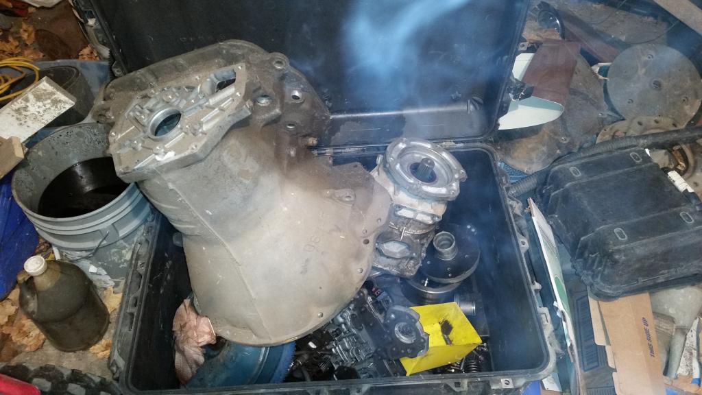

^This is my cold Minnesota winter day(which is happening sooner then I last remembered) "Project Notta Again"
I was in your type of dilemma, jasper transmission or get a rebuild. They both seemed way to much money especially a local rebuild.
I ended up with OPTION THREE: Doing it yourself!
I get that maybe you don't have the space or time, that can be an issue.
After doing the online research (along with a many whiskey cokes) I got a rebuild manual. Reading that thing from cover to cover I made my decision to order parts and do it myself.
Now what killed my rebuild was my stupidity of not knowing what rubber tranny line really is. Kept on blowing the lines found out everybody was giving me fuel/vacuum line. My luck tho
