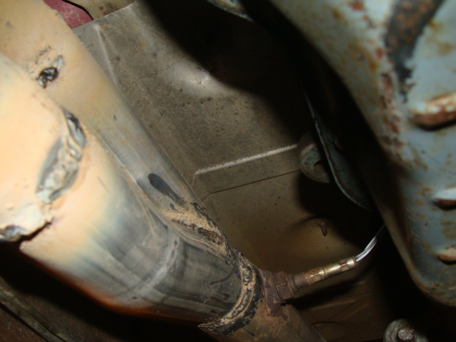

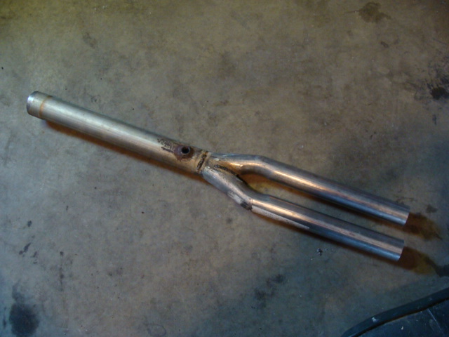

I'm no welder but it doesn't leak , honestly , lol . I ran out of gas and just used inner shield wire .
I had an exhaust shop bend 2 30* bends on each end . Came home , cut it up and welded this together after a few measurements .

I trimmed it to fit once the cat was out and welded everything to the truck . I did remove the pass side down pipe and new pc to weld it as I had no way of getting at it on the truck . I tacked it in the position I wanted first of course . Reinstalled it , and welded the drivers side . The bung was welded in while out .

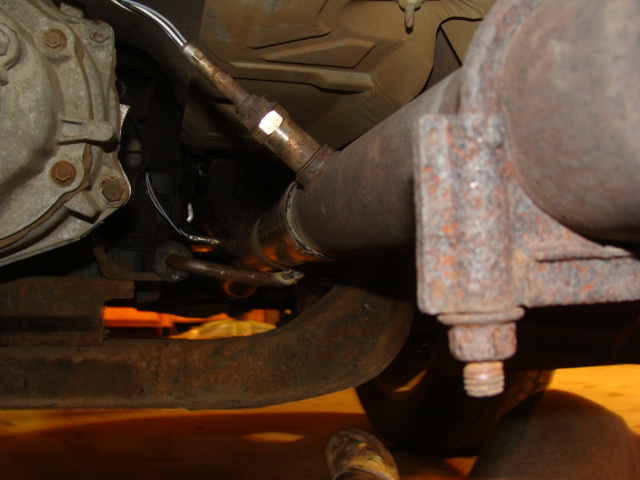

That's my fouler or cheater as I call it on the downstream sensor .

Because I had the fouler , the muffler , and can over look my welds , it cost me under $20 to do this VS $200 as quoted at the shop . My cat was shot
