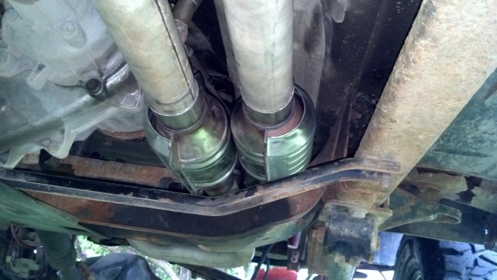

17 years no cat true dual with 2 H's one for each 02. As of this summer two cats, no H's for 02's pre in one pipe post in the other. Having two cats has not changed the sound, mpg or power. It does smell better and idle better though. Just my .02c run cats.
This is what I went with, couple of Magnaflows.

What size pipe Merc?
Old Dec 18, 2014 | 03:32 PM
  #30
merc225hp's Avatar
merc225hp
Joined: Oct 2009
Posts: 4,717
Likes: 10
From: N/A
It's all 2.25 supposed stainless, some is, some I beg to differ on. I used stainless band clamps as well. That was a test fit photo I gave the cats some room to move between them.
Edit to add: Stainless Magnaflow cats part #53005. And yes I have a muffler DI/DO Magnaflow stainless I think 18"
