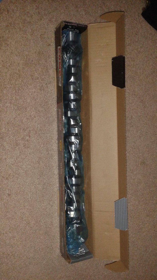

Update, picked up the cam today. Comp Cam # 20-746-9
