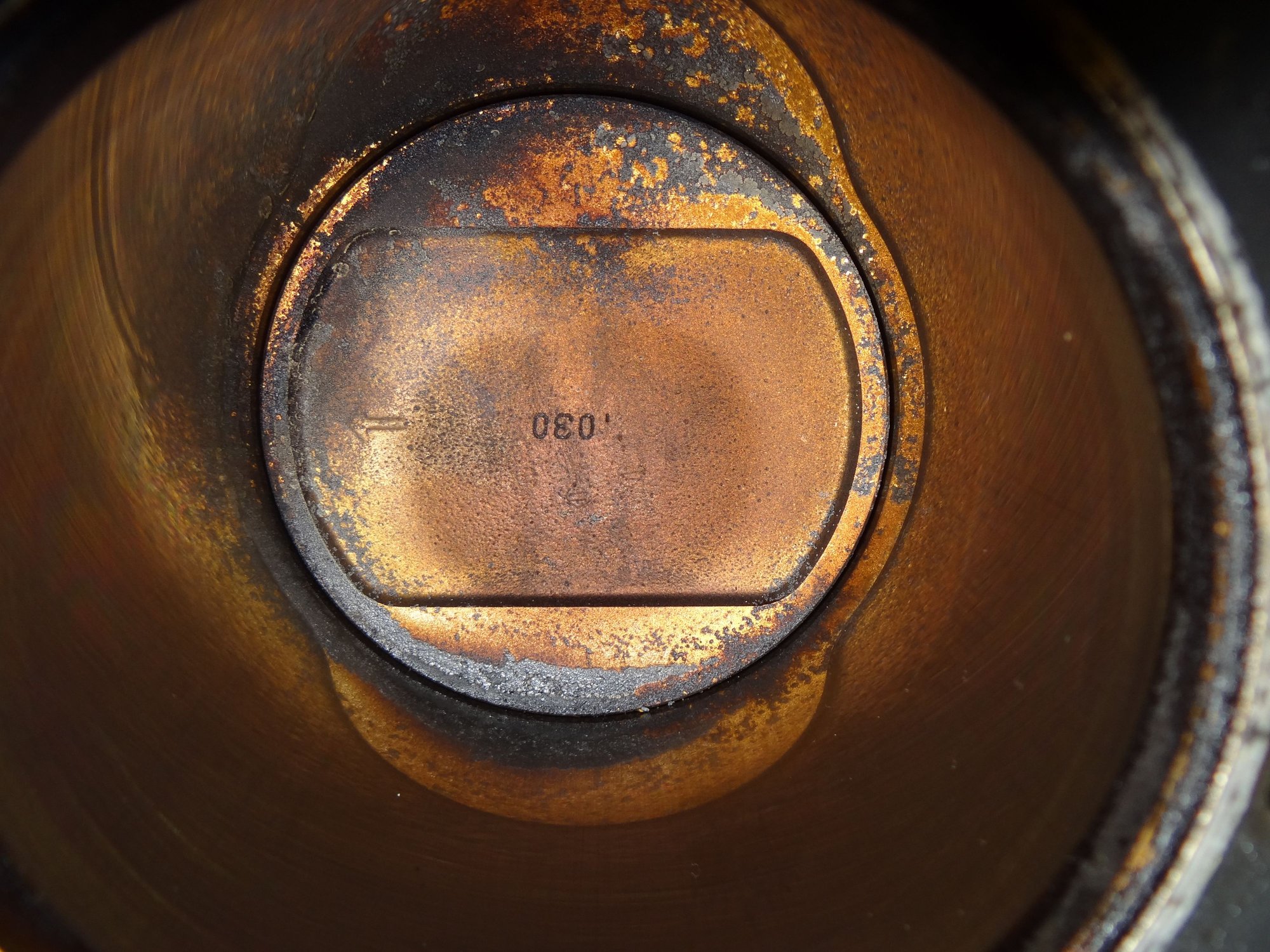

Oh yea, I found out shes bored .030 over as well.

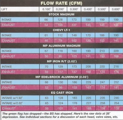

Stock heads stop flowing at .400" lift. So putting 1.7 rockers on probably won't do anything. Heck even that cam is limited by the stock heads. And if you really needed that much lift I would stick with 1.6 rockers and get a cam with more lift in it. It will save your valve guides and give you better valvetrain geometry.
Thank you!! that chart is extremel useful!! What are these EQ heads? I feel like alot of members here have them on their trucks and seem to flow pretty good.
