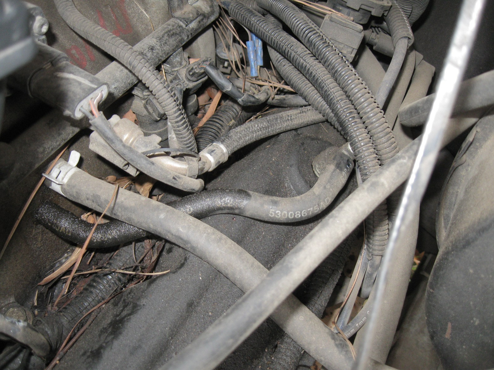

My truck has been off the road for a little while, a few mechanical things that the previous owner didn't maintain need doing.
One of the more confusing issues(the pictures hopefully explain it better than me) is that the PCV valve is just GONE, and the part of the valve cover where it should be is wide open. The intake port where I assume the PCV valve should plug into has been plugged with some other hoses, and it's a bit of a mess to say the least.
1996 Ram 1500 5.2 - What is going on with my PVC Valve/Vacuum lines?-td6sdmk.jpg
1996 Ram 1500 5.2 - What is going on with my PVC Valve/Vacuum lines?-oq3angn.jpg
This doesn't seem to affect the drivability of the truck, at least not that I'm aware of. Still, I can't imagine it's a good thing, and I want to take care of it, but I have no real clue where these hoses are going or what they're for.
If it helps, the only vacuum-related problems the truck has is that my climate control has wild vents, there's a port on the back of the air box on the drivers side with nothing going into it(I'm not sure if that should have a hose running to it) and the brakes are very sensitive(I'm assuming this is due to the brake booster.)
One other thing, I've read hearsay that a bad PCV valve could end up triggering a CEL for a bad o2 sensor, which my truck is showing. I'm going to be replacing the sensor regardless, but is there any chance that's not just a coincidence?
Thank you. please excuse the forest between my intake and valve cover

That broken off piece should be the PCV valve. On the drivers valve cover, there should be a 'breather', with a hose going to the hole in the air box.
Wild Vents: Replace the check valve in your vacuum line, I don't even see one there.

You should have a breather on the driver side, and it should go up to your airbox. It looks like you have a PCV valve there though...
The broken piece on the passenger side is where your PCV should be, and there would be a hose going into your intake where that blue vacuum joint is hooked up.

Looks like someone updated the PCV system to the newer style. (think it changed in 00, or so?) Had the valve in the drivers side, and just an elbow on the passenger side, then a hose going up and over the air box, to the fitting there. Wonder if that's a replacement motor?

Your PCV is on the drivers side and plugged up accordingly to the intake.
On the passenger side. That is a breather with a hose that runs to the top of air hat. Their should be a little place to put a vacuum line on the air intake housing.
That breather can be bought at oreillys for like 4 bucks.

Oh well that spiel be correct for a 96 year.
Perhaps someone swapped in a later engine?
But yes. That little breather and hose and you should be fine.
Do you have a little post thing on the passenger side of air intake right beside where the air intake piping from the fender comes in? If not you might have to convert it back or do some funky wiring.
