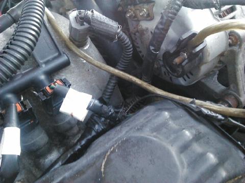

just finished putting in my motor and guy who was doing it before had wiring ran. so i am confused as to where these two wires go on the fuse box... also the alternator wire was not ran and i belive this one to run to the battery???

Alternator wire goes to the power distribution box, to the same terminal the positive battery cable goes to.
I am not sure which two wires you are referring to in the first pic.

i mean the two big wires on the fuse block. Does one go positive and one negative?

No Batt negative leads go to the PDB.
Off my batt + terminal, one wire goes to the starter, one goes to the PDB (first stud).
Before the fuse (first stud) goes the batt 12v+ supply wire, other stud is alt amp out, thats it one wire per stud.

+1 what merc said

thats what i was thinking thanks...

this prolly explains why i burned up two PCM's before checking the damn wireing.

Thats not good sorry to read that. I would expect the ckps and cam-sensor is toast as well maybe more.
