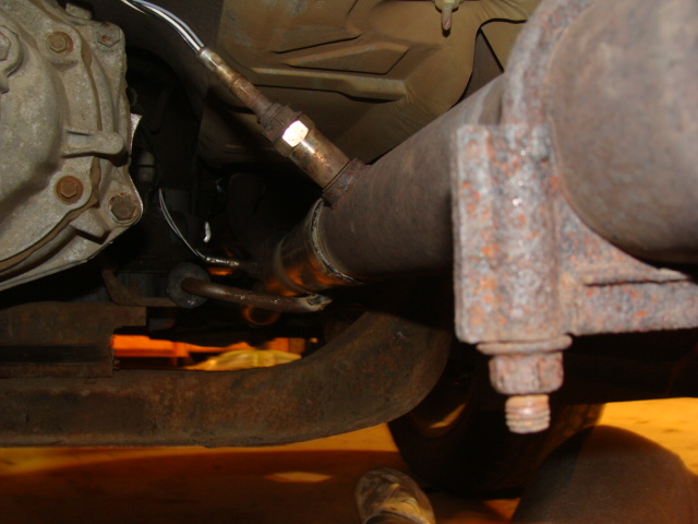

The 02 sensor in question is the rear sensor . Here's a pic of mine with the cat removed . Upstream (farthest) is mounted normally in a bung , downstream(closest) has a cheater on it . It takes it away from the main flow reducing it's reading to somewhat normal . If that downstream sensor is not cheated , it can run like crap , and not flash a CEL .

Rear O2 sensor is just to monitor cat efficiency.... it can have a minor effect on mixture.... but, nothing compared to the front O2.
