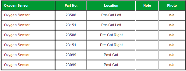

I am trying to find out which is correct for mine since I wanted to just order all my stuff off RA. How come there are multiples for the right and left?

Old Apr 2, 2015 | 05:54 PM
  #28
Posts: 87,480
Connector shape, I do believe. See which ones you have, and make sure you order the correct ones.
Old Apr 3, 2015 | 11:25 AM
  #29
Moparite's Avatar
Moparite
Joined: Feb 2015
Posts: 7,435
Likes: 578
Yea connectors and wire length. Look at yous and find out what you have before ordering. The #'s that ra gave me for my truck where off so i had to research it.
