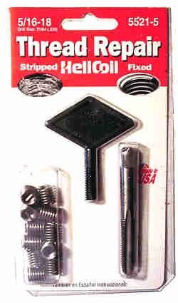

Helicoil it! There is another brand out there to i think it's called re-coil. Some kit's come with the drill bit. Just make sure you have the drill bit before you buy it.

it's the front differential pinion yolk
Where the pinion yoke coming out of the differential where the bole goes through the u strap then into the yoke, the bolt hole is too big.I want to know can I just drill it out use a long bolt & add a nut..I hate help coils btw
Why? They work just fine if you do it right. If drill it out and can put a nut on the back it may unbalance it enough to feel it while driving.
