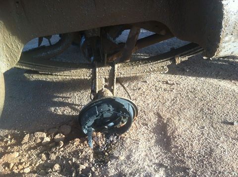

Originally Posted by Moparite
I'm still trying to figure out why put a d70 in a 1500? A bit of overkill.
This is why: And imagine this is only with 35's lol
