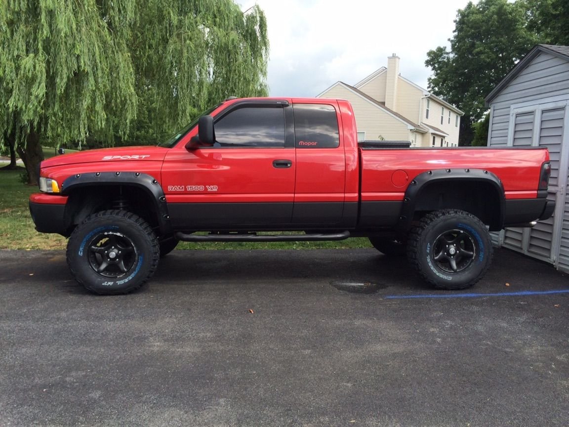

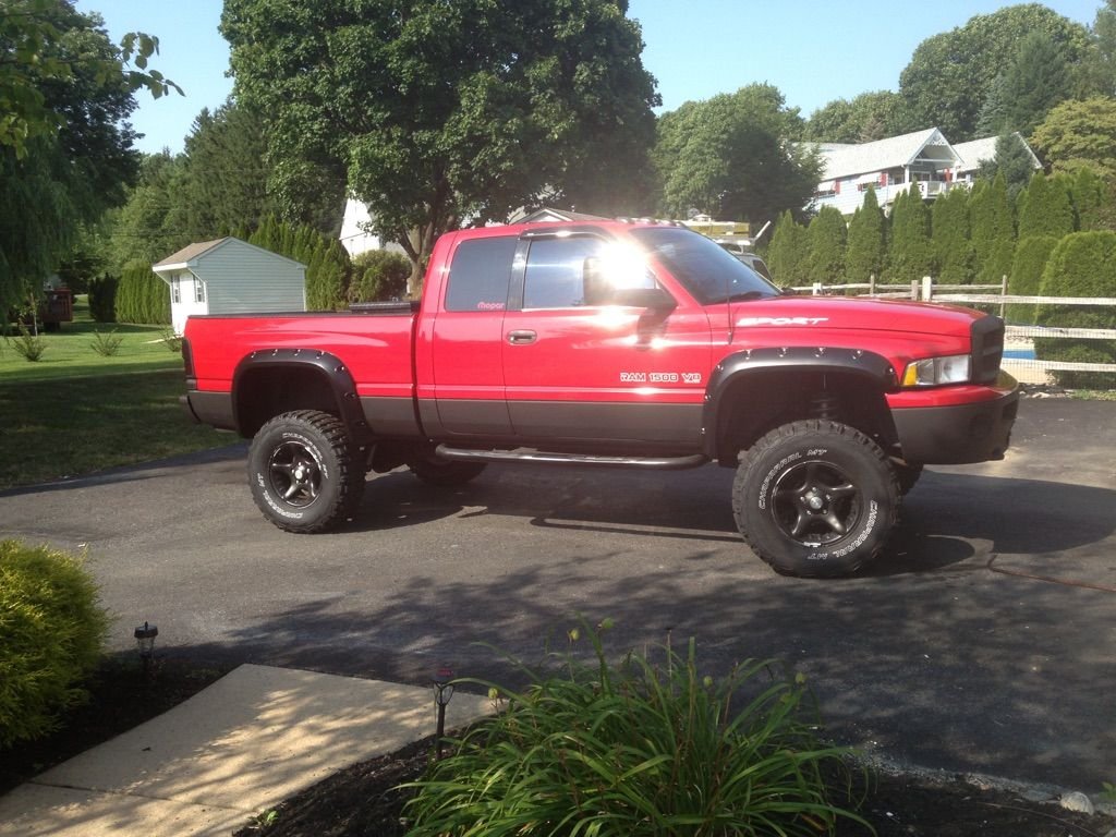

There she is. The only addition that was done recently is the roll bars.
