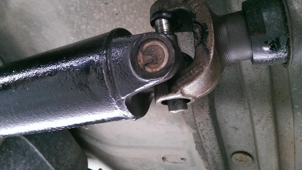

Yep. Make sure c clip is seated. I always clean out the grooves with a pick now
