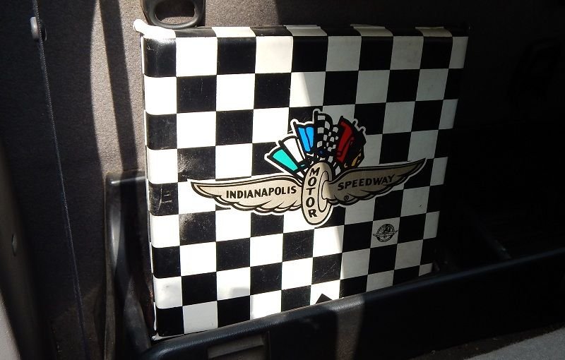

There where 2802 indy rams produced. I have seen some real bad paint on indys to the point it was down to the metal witch turned to rust. Why anyone would let it get to that is beyond me. Not sure of all those paint prices include but you should be able to get it done for less. especially if you do the prep work witch is a big chuck of the total price. I looked for about 3 years before i found a decent one to buy. Upon delivery i found this behind the seat.
I'm thinking that mine may have have been one of the 150 that where at the track in 96. Still searching for info on this.

Is that a bleacher seat cushion?
Thanks for the photo! It appears that they all have lids.
That's exactly what it is! I know the ones that where there came with a certificate stating it. Info is sketchy on some of the details. I want to see if there was a dealer brochure just for the indy's because there was no mention of it in the regular ram pick up brochure for that year. You can do a google search and find out most things about them.
