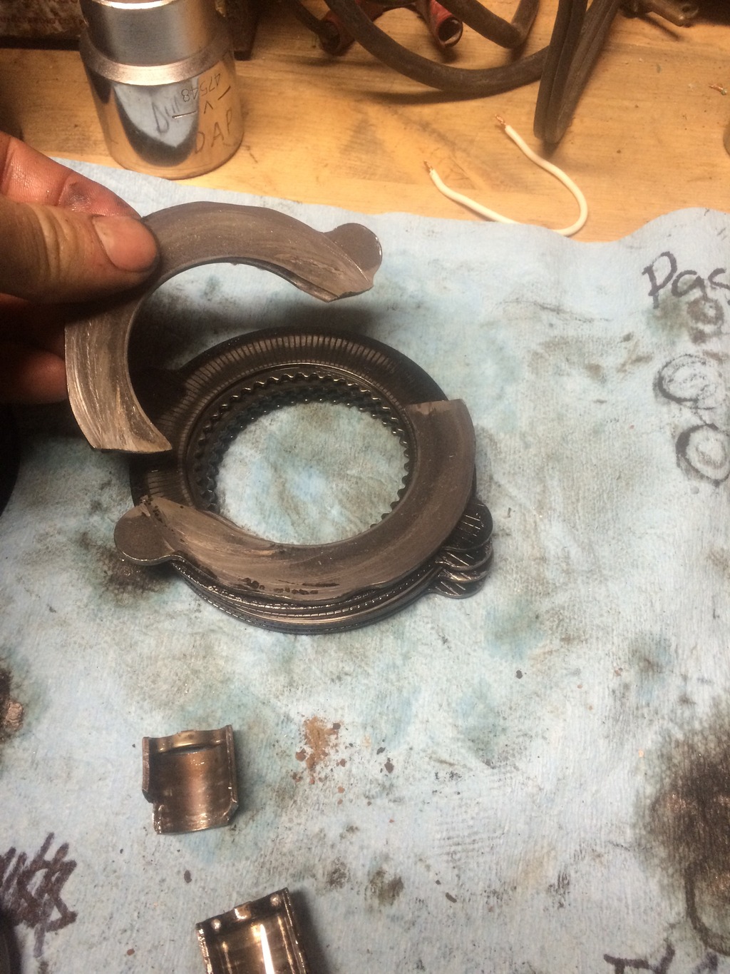

Found the source of the rear end noise. What do you guys think? looks like spalling? this is the rear pinion bearing, maybe got to hot and insufficient lubrication?Name:  image_zps0rqmsxfu.jpg

And of course found a broken clutch plate spring....Name:  image_zpsm6ucjctr.jpg

Holy. Hell. That must have made a racket. And I thought mine were toast.

yeah that sure was the worst race I've ever seen....

I can see how that might be just a bit noisy.......

Well she's all back together and appears to be driving well. I guess we'll see how long she lasts. I took my time setting it up so I think all will be well. Gear pattern came out pretty good but I was concerned about backlash. Before tear down backlash was .012", should I have kept it at that considering the ring and pinion have worn together with that backlash?

I set it at the loose end of the spec from the manual I was using, 0.008". But now I wonder if should have left it at 0.012...

Should be ok. Consider some of your backlash was from wear. Don't think it'll be a problem.
