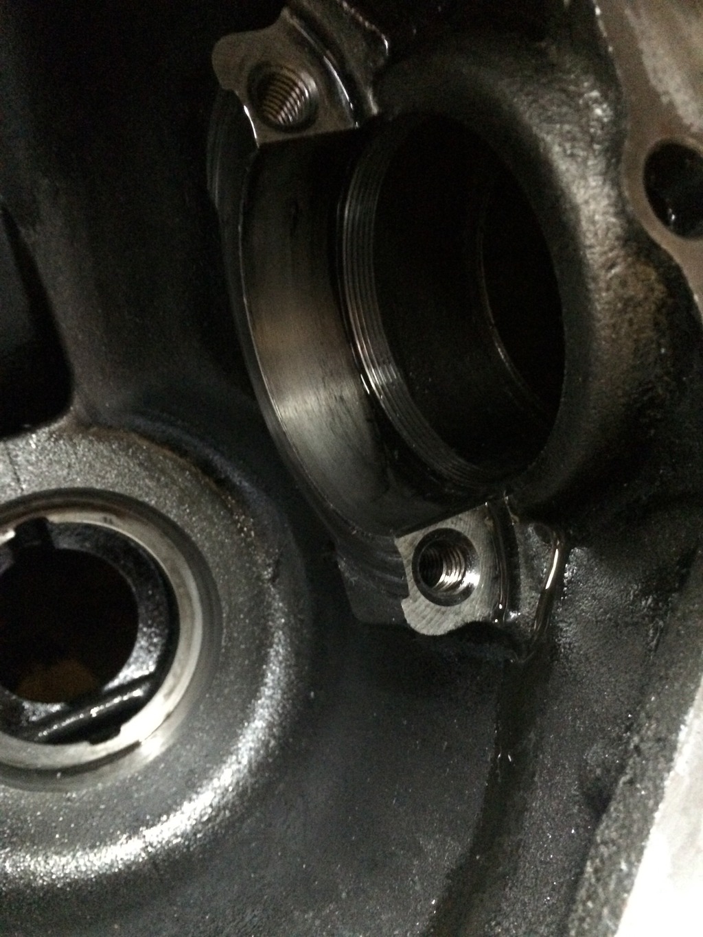

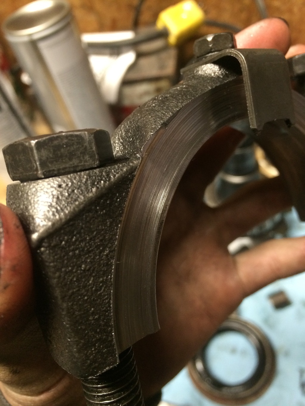

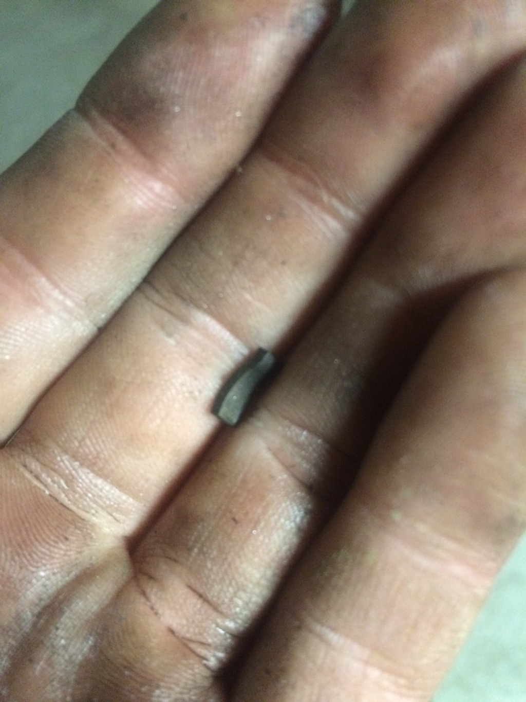

okay guys so i got it all apart, and not really surprised at what i found. broken LSD clutch retaining clip, and damaged bearing caps/housing.
The damage is pretty substantial, and money is tight, but considering the age, and mileage of the vehicle I'm pretty certain I'm just going to proceed with the rebuild. I am however interested in what you guys have to say. With your honest opinion, what do you think of the damage? any reason i really should not replace the housing/bearing caps?
FYI, all the bearings were roasted, especially the front pinion bearing.

Old Oct 4, 2015 | 09:22 AM
Posts: 87,406
Likes: 4,214
Those are kinda chewed up.... If you can find another rear, in decent condition, replace the whole thing. Can't just put new caps on it. They are precision machined...... and even a couple thousandths off will grenade any new parts fairly quickly.
Good to know about the caps. Unfortunately I phoned all the wreckers around here last week, and nobody had a complete rear axle assembly. Is the problem just that the part that is chewed up is right where to bolt threads are, and could possibly weaken it?
