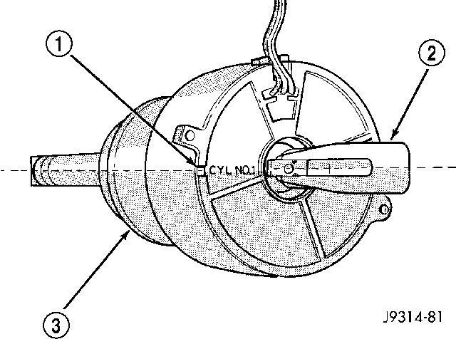

Got a 318 in a 1995 dodge ram 1500 2x4. Broke the bolt that holds the cap on so I replaced the distributor. Did not relieze that these engines are not timed with a timing light. I attempted to manually set the index/fuel sync but could not find the *v8* mark that it's supposed to be set at after tdc. Any advise where this mark is? A photo maybe. I looked on the damper but to no avail

Procedure for setting fuel sync (static) is on page 8D-27 of the 95 service manual. You can download it from here.
